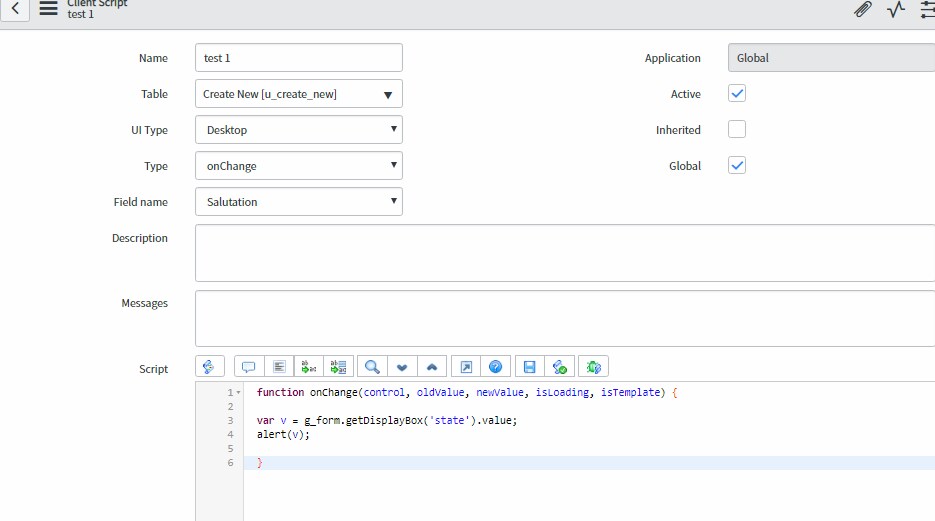

Im getting this :
Hi i tried g_form.getDisplayBox('state').value;
but its throwing error -
Can you tell me whats the error here?
