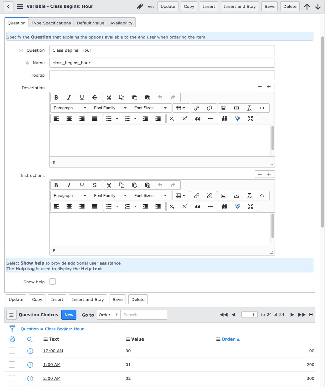

Here's the setup;
And for the selectbox options:
  - "3:00 AM" text returned with ${current.variables.class_begins_hour} in the notification activity message field
  - nothing returned with ${current.variables.class_begins_hour.getDisplayValue()}
