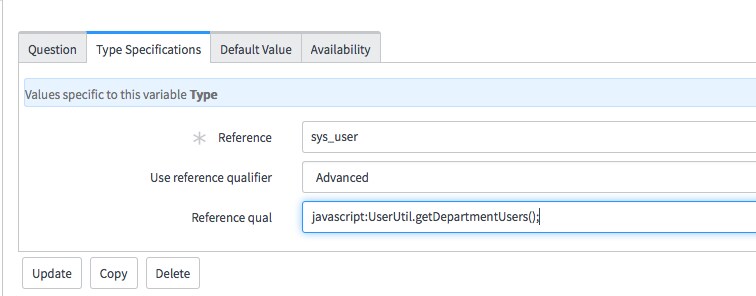

In the reference field's reference qualifier write the below code -
javascript:UserUtil.getDepartmentUsers();
Create a new script include:

It is good and easy to use the filtered conditions like above, but it is usually good to go for a script include and function in the reference qualifier - in the condition.
The most important advantage of this kind of scripting is reusability and if any need of modification, you need to modify at one place and it gets reflected in all the other places. Its the best practice to do also.
Reference Qualifiers - ServiceNow Wiki
So in your case -
