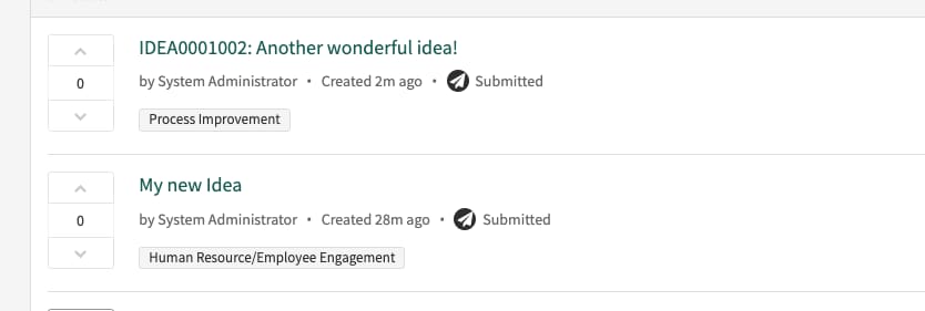

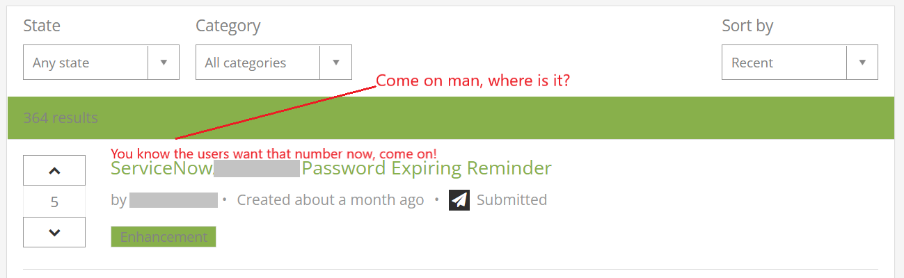

Idea number in the title have been disappeared in Rome. Ok, where did they go?
How do I update my config to once again display idea numbers in my list of ideas on the portal.
Before upgrade
After upgrade
You're killing me Smalls. Where do I change this back so my users don't have go into fits?
thanks in advance

04-27-2022 02:36 PM
Honestly? It looks like they modified the widgets to remove the number from the portal.
I don't see any configuration that would let you add it back, out of the box.
I think you are left with one of two options; add a business rule and force it to the short_description on insert, or modify the OOB widgets that display the data. I'd suggest the BR.
Simple enough - create a BR for the idea table, on insert with one line of code.
current.short_description = current.number + ': ' + current.short_description;
Get's the job done.
If you want to modify the widget it looks like you are able to do so - it is editable (I suppose for possibly this reason) just keep in mind you change it, you own it going forward. The ID of the widget is im_ideas_list
It would be a much more challenging enterprise to modify this one, given the way they pull in the data - they just are not including the number anywhere in the data being queried so you would either have to modify that script include (not suggested) or create a process to get the numbers and match them up in your HTML (can be done, just not simple).
I hope this helps!
