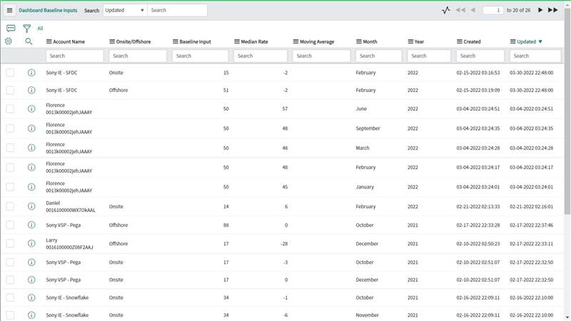

I want the script for the following requirement.
We have a dashboard baseline input table.image
In screenshot you can view the column names.The requiremnt is -to calculate the moving average of each months.
Based on any single account :"ABC", onsite and year there are different Median Rates for each month.So,we need to calculate the average of them on month basis.Such as:for January median rate=2,feb =3,april = 4 ,then moving average will be for january=(2/1)=2,feb=(2+3)/2=2.5,april=(2+3+4)/3=3 and for march there are no records ,then moving average for march will be =same as feb that is 2.5.
Just like this for account "ABC" for offshore another records will be there..so moving average will be different for them and also when year changes moving average will also changes based on the records.Refer the below screenshot
Please help me for that with the scripts as soon as posible.
