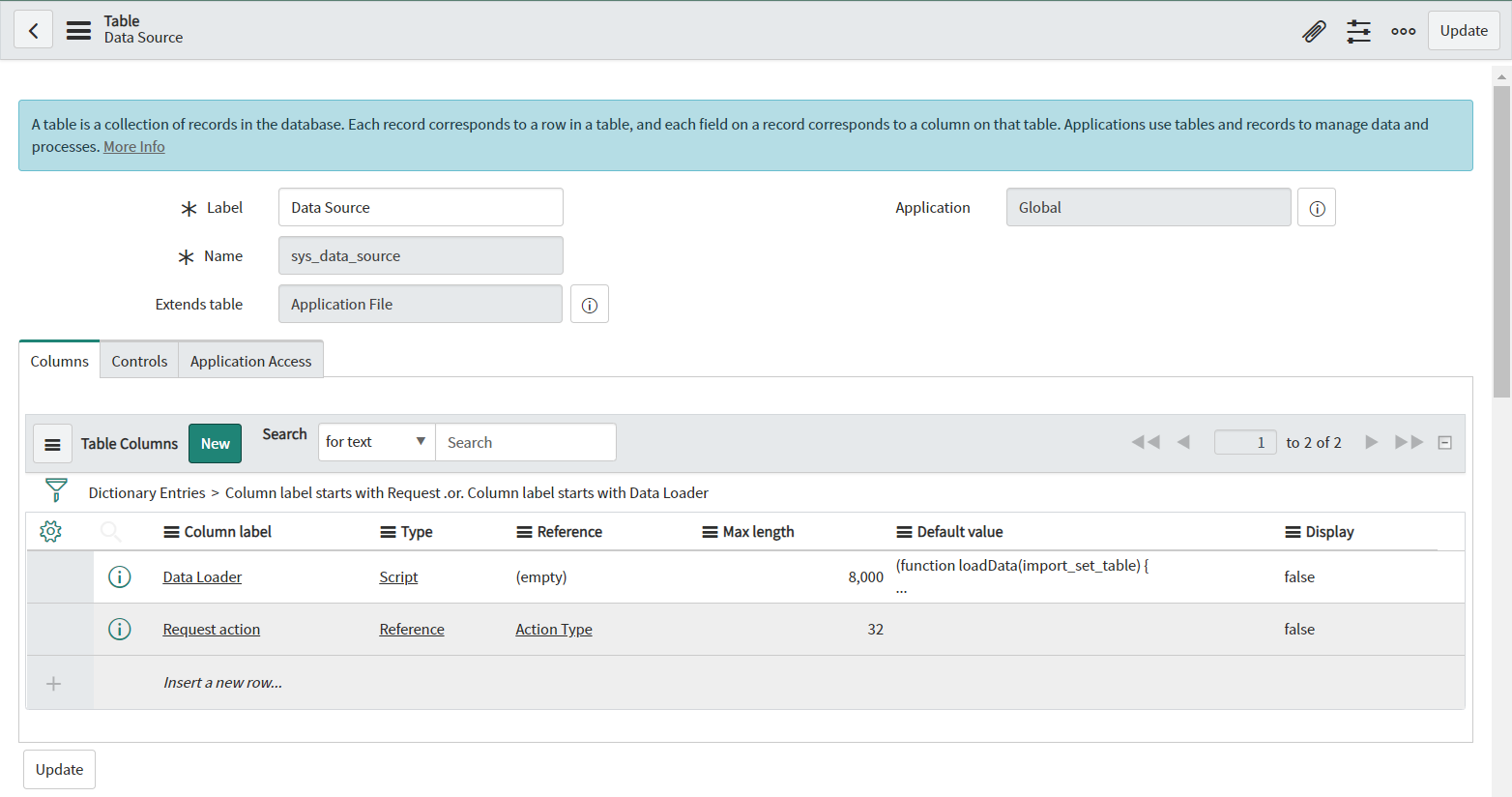

I have checked the form view after saving the record which is as shown in below image
Also, I have checked whether the fields exist or not in Data Source [sys_data_source] table. So the fields are exists in the Data Source table.
Thank you

Hi @Ankur Bawiskar
Thanks for sharing your instance image. I have checked in two dev instance but getting same results. So is there any plugin issue ? or do I need to install anything else except IntegrationHub from the Plugin ?
