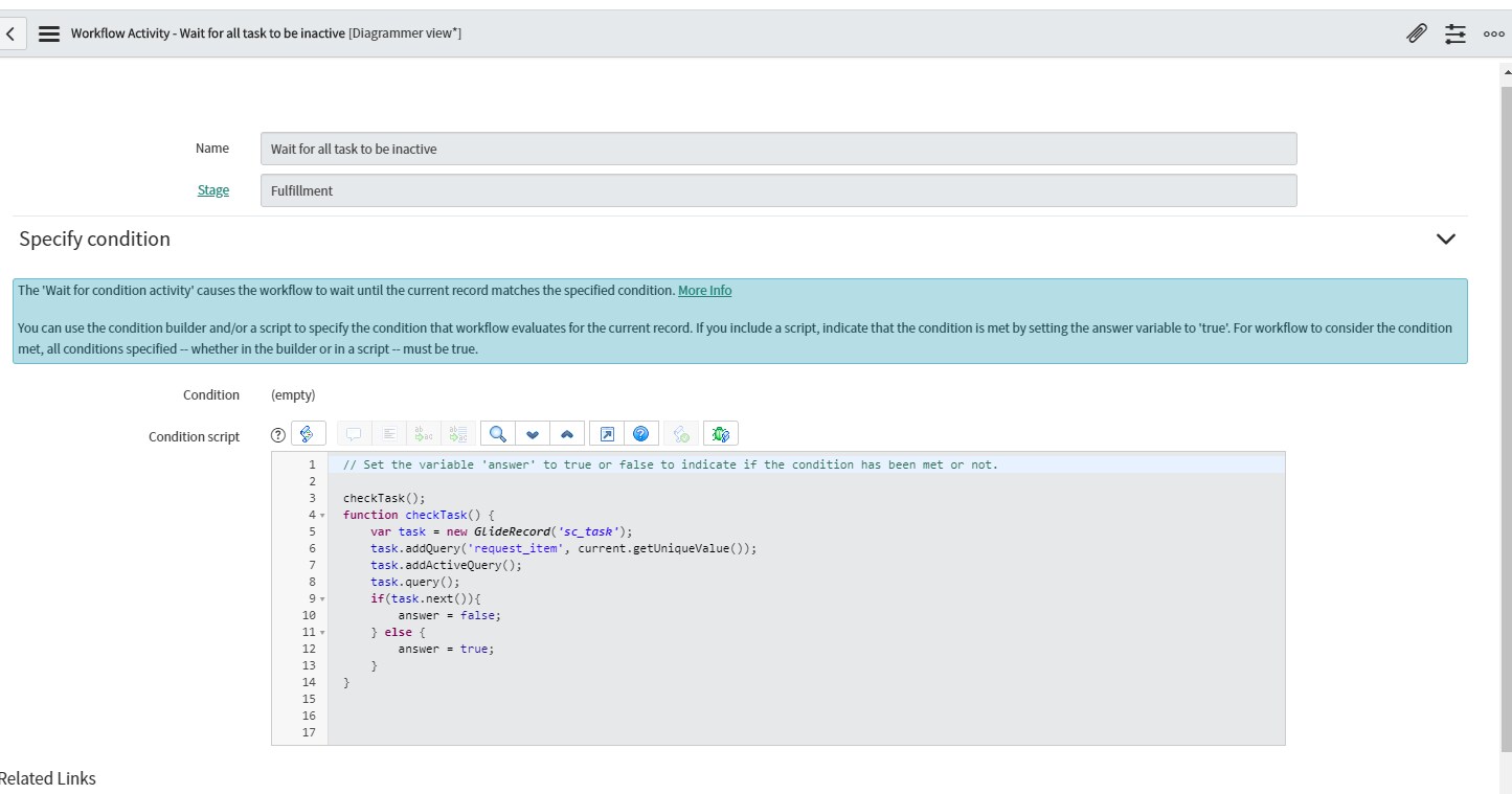

Hi Heather,
Can you amend your wait condition to be something similar to this and see if this works as you expect:
Sam

Sam Ogden
Hi Heather,
The issue with having a wait condition in the workflow is that it is only checked when an update happens on the RITM record.  As the wait is based on the sc_task and marking this as false does not cause an update to the RITM the workflow will just get stuck at that wait condition. This article might be useful to create a business rule that runs when sc_task active changes to false which makes an update to the RITM.
Hope this helps
Sam

Apologies Heather,
I was getting confused, I can see that you just have a single task created by the workflow.  Can I check what you have set in your 'Wait for Active to be False' activity?
I'm assuming that on the catalog task activity the checkbox 'wait for completion' is not checked.  Is your workflow then getting to the wait condition but then not progressing any further?
Sam
