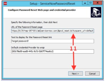

sandeep p1
Mega Expert
During installation, you will see the below step, where you have to put your reset URL in the 'URL of Password Reset Page' column.
Please mark this answer correct if it resolves your issue.
