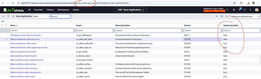

Please check the table: sys_store_app

you can check the sys_store_app

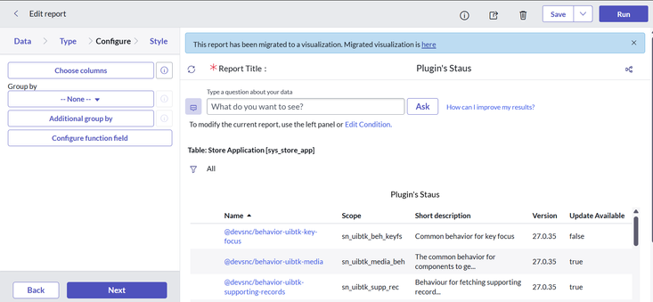

07-18-2025 03:24 AM
Hello @an261998 ,
The table name has already been mentioned by both experts ( @Chaitanya ILCR & @Chaitanya ILCR ) — it's "sys_store_app".
However, this table isn't available for reporting by default.

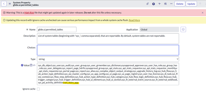

To make it reportable, you'll need to do the following:
Update the "glide.ui.permitted_tables" system property that controls reportable tables and include sys_store_app in it.
Once that's done, check if the table appears in the reporting UI.

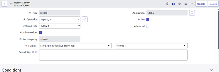

If it still doesn’t show up, you can create an ACL on the table with the operation set to report. This usually makes the table accessible for reporting.
After that, you should be able to build your report as needed.
Finally, once the report is ready, you can add it to any dashboard where you want it displayed.
