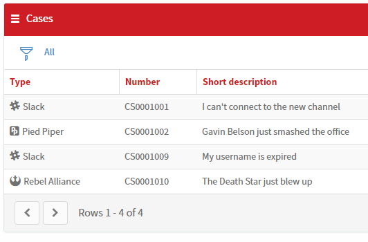

I think I found a cheeky (though still reasonably OOB) way to do this...
1) Add to you list view a drop-down field that you want to use to drive the icons (could be a string, but needs to be a finite list of possible values)
2) Add CSS to the widget definition as follows:
td[aria-label="Slack"]:before,  td[aria-label="Pied Piper"]:before, td[aria-label="Rebel Alliance"]:before{
    font: normal normal normal 16px/1 FontAwesome;
td[aria-label="Slack"]:before{
    content: "\f198  ";
td[aria-label="Pied Piper"]:before {
    content: "\f1a7  ";
td[aria-label="Rebel Alliance"]:before {
    content: "\f1d0  ";
3) You can now see the icons showing up (only tested in Chrome):
Full list of icons can be found here
(FontAwesome should already be part of your Service Portal install)
    content: "\f198  ";
    content: "\f1a7  ";
    content: "\f1d0  ";
