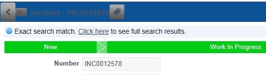

We are implementing the Global Search function for all users, but have come across some issues. We have built a new ESS portal, created a new header, and all of our links are working correctly. However, when a user does an exact match search, the default view takes over and all of our CMS changes are rendered useless:
I have gone to User Preferences and set ts.match to false so it will force into the list view, which is nice and works just fine, except for non-ITIL users. It shows them this:
When I turn ts.match back to true, it will display for the user the exact match of that incident/task/etc, but our CMS is still absent. I have also messed around with the ACL restrictions, but none of them allowed any additional view for the user. Only changing the ts.match from false to true gave any results.

First, go to User Preferences and find the "ts.match" preference. It's does this specifically: Global Text Search - return task if search term is task number. You will want to set that to Value = False. This will take care of all of your ESS users.
Second, you will want to set the Global Text Search preference to Default. There are two preferences to change as seen below. Make sure both of the boxes blank
| Form view to use for Global Text Search exact match - blank means Default view |
| List and form view to use for Global Text Search results. Blank means default view. |
We found that if we did not do both steps above, ITIL users were not seeing the default view of some records, specifically Ad Hoc Requests. They do not have the ability to change their view so it was causing issues.
