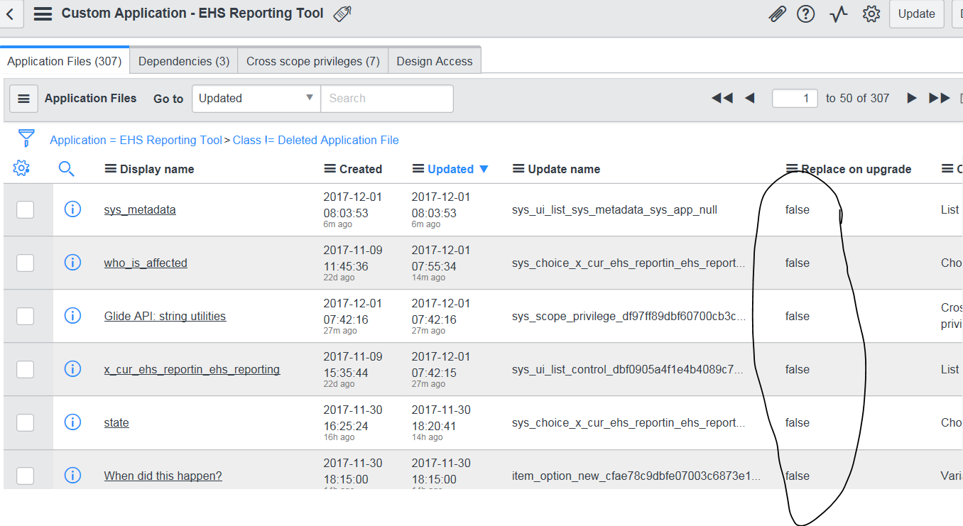

That said, when I look at my list...I'm seeing "false" for every edit I'm making to my application...however some edits are going through and some are not.   Is there more logic I'm missing to how to make certain changes go through?
one specific edit that is not going through is when I set some of the choices for a field on a table in my scoped app to "Inactive=true", this does not pass to the TEST instance when I do an update.

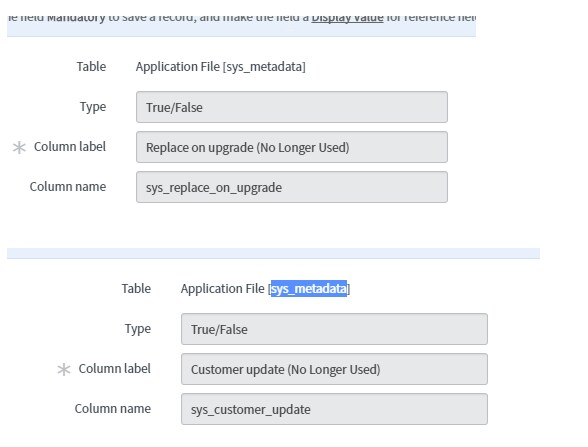

The 'Replace on upgrade' and 'Customer update' fields are now deprecated in the Metadata table.
