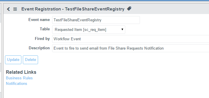

System Policy   >   Events   >   Registry
Create registry entry with details as below:

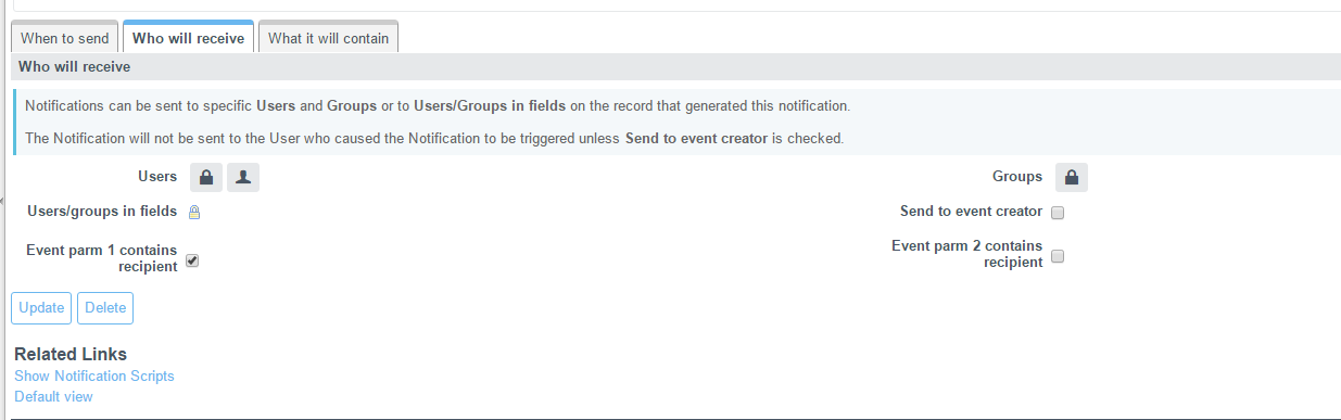

Email Notification
Table:   Requested Item   (NOTE:   You may need to change this depending on what table you are working on)
Send When:     Event is fired
Event Name:   TestFileShareEventRegistry
Tick the "Event parm 1 contains recipient" option.   This has been passed through in our "Run Script" activity in the workflow.
Message HTML:   Create your email notification
