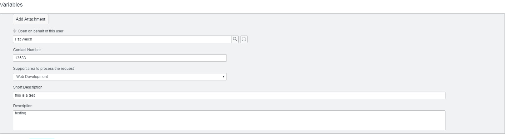

After submitting a request, the variables are carried over to the RITM record as editable. Do most companies leave as editable or make read only? What are the ramifications either way? If best practice is to make read only, what is the best way?

Hi Patricia,
Most make them read-only as they are part of the original request, may be used as FYI for approvals, etc. and should not be changed once the process has begun. There are exceptions to every rule, of course.
The best way to make the variables read-only is with a catalog UI policy. You can have it apply only to the request item (and not to the catalog item when the user is filling it out.)
