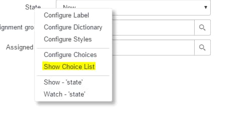

Also, when you go in the form designer it should look something like this (using incident as an example):
