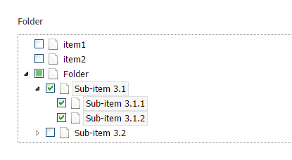

We like to develop our own catalog variable type, but we don't find any information how to register such a new type.
Is there a table where the code is stored?
We would like to generate a selection tree for managing file system access based on a table and their relation to parent/childs. (displaying an 'UI Page' Variable)
Unfortunately it is not possible to do a data binding based on the selection once the form is submitted. We would like to store, which checkboxes has been selected and use them to run a workflow/orchestration.

Would it be possible for you to share your UI Page (the tree-type layout with the check-boxes) ?
I'm also in the same use-case as you and have been looking for workarounds.

We stopped our development on this element until we move to Helsinki.
So I can't provide any working example.
(Have a look on this jQuery Plugin GitHub - mar10/fancytree: Tree plugin for jQuery with support for persistence, keyboard, checkboxes,... )
