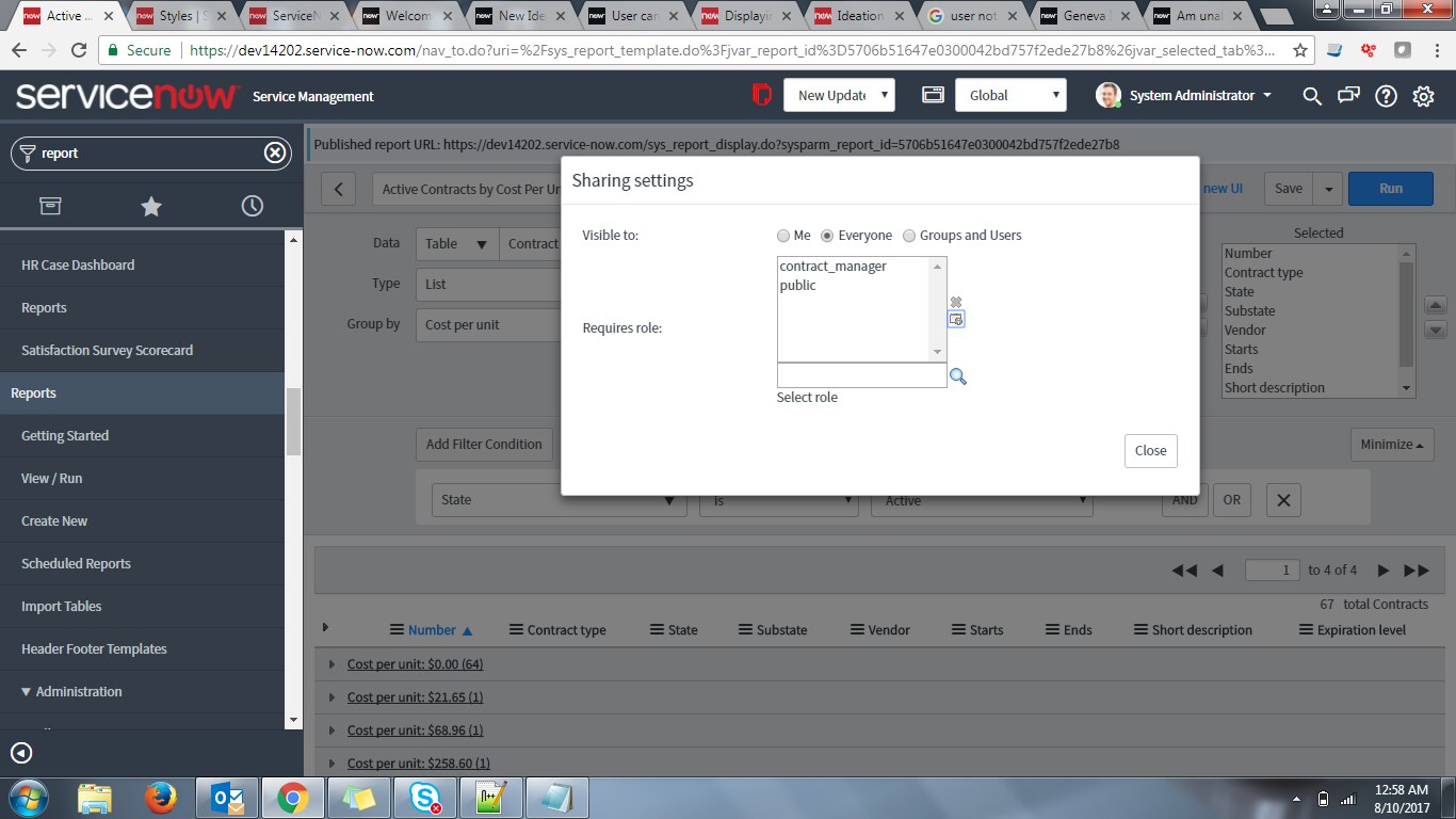

this report belong to particular   group or users. if it's then this user is a part of that.
have you shared this report?

we have this write ACL on sys_report table, that only allow these cases to write reports:
A user may update his own reports and may update global reports if he has the report_global role.
He may update his groups' reports if he has the report_group role.
A user with report_admin role can update any kind of a report.
Here is the ACL:
https://<instance_name>.service-now.com/sys_security_acl.do?sys_id=8fe36cefc0a80165000e52530a8763d7
https://docs.servicenow.com/bundle/istanbul-performance-analytics-and-reporting/page/use/reporting/t...
Please let me know if this helps
