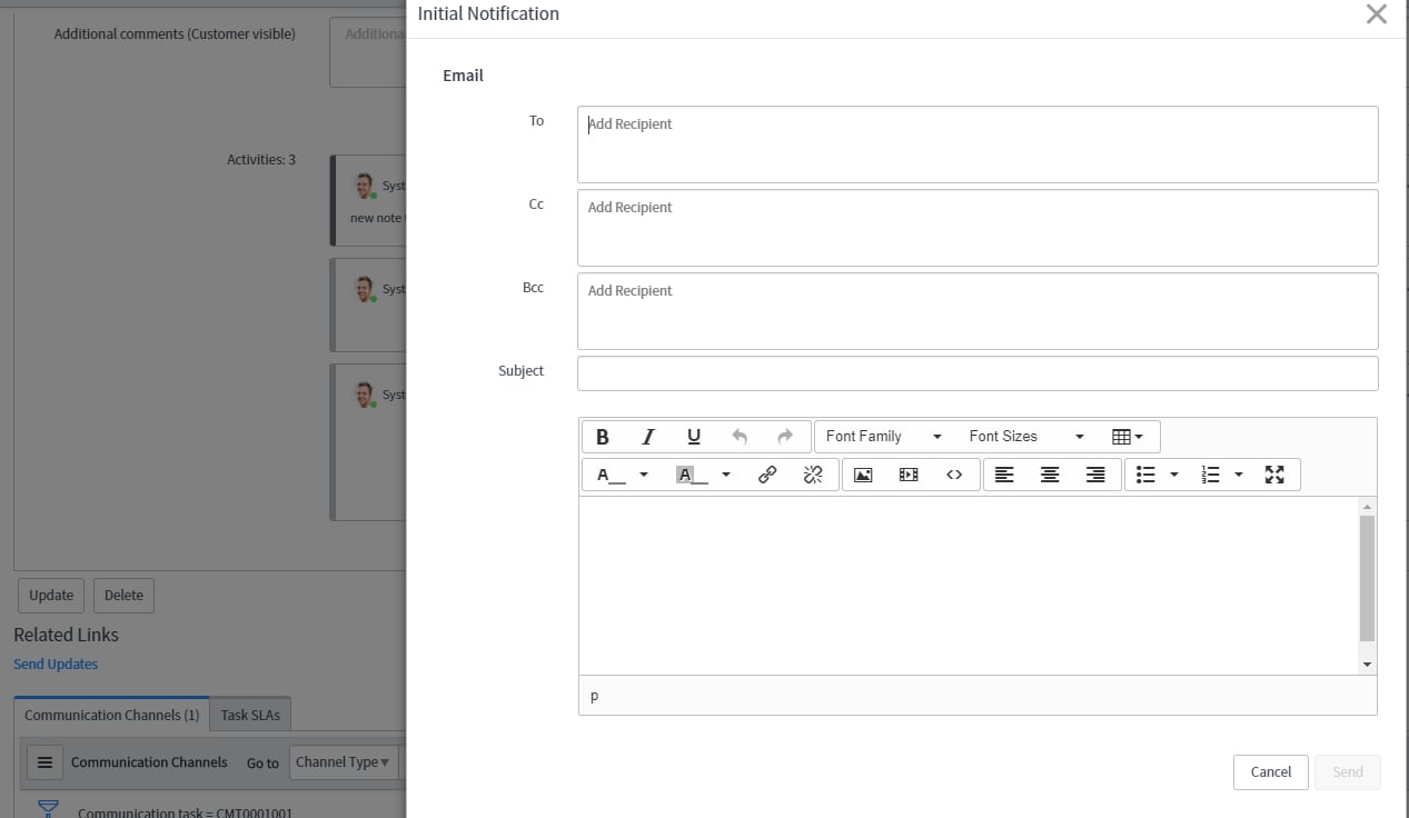

However when I go to the communication task and select the 'send updates' related link, the email pop-up is not populating the 'To:' field with the users from the recipient list:

I managed to hunt down the issue.  I had a look in the UI action 'send updates' on the communication task and this calls the script include 'CommunicationManagementUtilSNC'.  Within this there is the function '_getContactsForEmail'.  I noticed in here that it was only adding the users from the recipient list to the 'to' field if the recipient_list.type was 'internal'.  I had set my recipient list type as external.
I've amended the extended script include for this function so it does the same for recipient list type of external and its now working as I was expecting.

I had the issue with "internal" recipients only working and found another issue. This tooks me days to figure out including a ticket with ServiceNow Support (which didnt help).
You need to update the Default in sys_email_client_configuration.list to include "Active Recipient Lists" else it shows the Recipient List on the email client but ignores it when sending the email.
The script include ignores the recpient list unless it is added:
