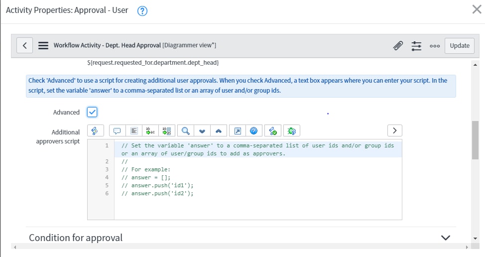

You have to use Approval User activity in workflow. There you have to write below code in Script section. See below
I have mentioned script as well in Script box above.

Can you provide context to where this should go? Based on your example I am trying the following in the scripting area for Approval- User on the workflow:
current.variables.cost_center.cmn_cost_center.code.toString();
I am receiving the following error when I attempt to use this code for the approval user:
"illegal use to getmessage in class org.mozilla.javascript.rhino exception"

Thank you for the info. I am no longer getting the error.
I am noticing now that it skips this approval now in the workflow. Like there is no approver.
