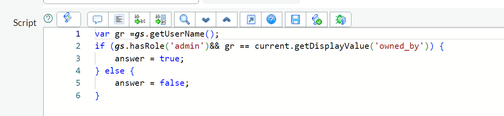

@mkader, I tried with below script but it is not working, so could you please assist me on this.
Ashok

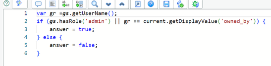

01-20-2024 09:38 AM
@Pranesh072 , I tried with below script but it is not working could you please assist on this.
Ashok.
02-05-2024 02:57 AM
@Ashok59 owned_by is reference field. gs.getUserName will return the user_id of the user.
you can use
gs.getUserID() == current.getValue('owned_by')
