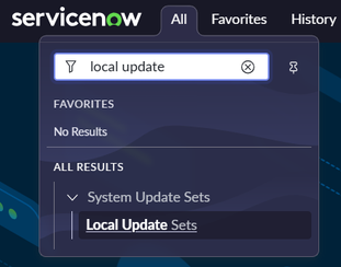

Hello @nicoleowens
Steps to create update set:
  • Navigate to All -> System update set -> local update set
  • Fill in the required details.
  • Click Submit or Submit and Make Current to activate the update set.

Hi @nicoleowens - How's you? Sure - that's no problem at all.
Creating update sets are pretty simple.
In the Navigation menu, type 'Local Update Sets' and select the option which will present a list of the current updates sets on your instance.
In the top right hand corner, select the 'New' button and fill out the Update set name etc.
You can then click on 'Submit and Make Current' which will both create and make the update set the current one which will start saving your changes.

Hello @nicoleowens
