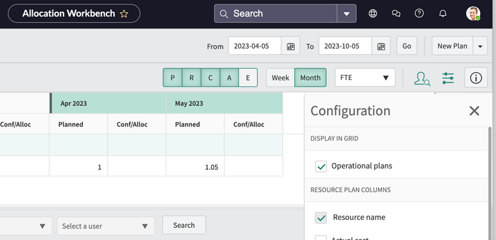

Allocation workbench not having the Operational plan selection under Display grid column .
04-04-2023 11:27 PM
One of our instances is upgraded to Utah . We don't see the Display grid column and Operational plan checkbox in the configuration in the allocation workbench .
The type we have selected is 'Group' so ideally it should show the operational plan. But it doesn't
Can someone give some insights on this.

Hi Sandeep,
I am more interested in knowing why my Operational checkbox in the 'Configuration' doesn't show up . Is this a defect in Utah?
The above doc tells how to create one operational plan , I don't see the drop down list next to New plan too.

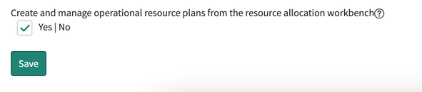

Hi @Shyna1 ,
Please follow below steps to get the option in resource allocation workbench.
Maybe during / after upgrade, the properties is deselected by admin (a guess)...
Hence,
1. Ensure that admin has checked the option as shown in below screenshot from 'Project Administration > Properties - Resource' (from left navigation)
2. Once the property is enabled, the resource manager will see the operational plans option from allocation workbench. Enable this checkbox from the UI.
