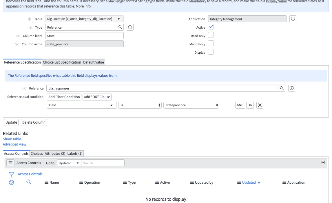

Can you screen shot the dictionary view for those fields?

I really don't see any issues and we have reference fields with 100s of choices with no issues.

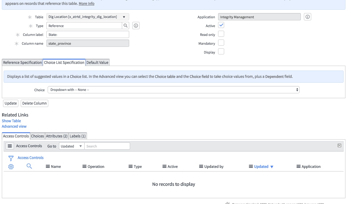

Under Choice List Specification tab: Choice, try setting that to - - None - - and see if that has an affect.
09-06-2016 01:06 PM
Hi Michael, We are in Helsinki if that matters. I tried the --None-- previously and all other options. We just tried adding the attribute max_ref_dropdown and set it equal to 100 and it worked.
