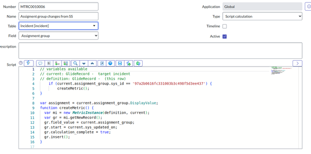

Below is an incident_metric for specific assignment:
The code utilized is:
// variables available
// current: GlideRecord -  target incident
// definition: GlideRecord -  (this row)
    if (current.assignment_group.sys_id == '97a2b0616fc331003b3c498f5d3ee437') {
        createMetric();
var assignment = current.assignment_group.DisplayValue;
function createMetric() {
  var mi = new MetricInstance(definition, current);
  var gr = mi.getNewRecord();
  gr.field_value = current.assignment_group;
  gr.start = current.sys_updated_on;
  gr.calculation_complete = true;
  gr.insert();
(remember to update the sys_id of the assignment group.
This will give you below:
So basic, a metric will be created when incidents is assigned to Service Support assignment group.
Now then just create a report based on the incident_metric table:
With below conditions:
Which will give below:
Above refers to, that the assignment group is "Hardware", but the incident has been assigned earlier to "Services Support.
        createMetric();
  gr.insert();
