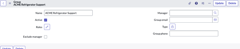

On the group definition form, you can add an existing field called Exclude manager.  Checking this box will stop the Manager of the group from receiving group notifications.

In the group make the field "Exclude Manager" to true then it wont trigger. As per system it will trigger email to the group manager even if he is not in group.
