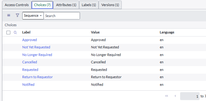

Then I went the 2nt table, I made the code in similar logic but it doesn't work.
var transaction = new GlideRecord('x_shlt_shinsei_request_approval');
transaction.addQuery('request_number.state', 'IN' ,'Resubmitted,Submitting,requested,Return to Requestor');
transaction.addQuery('request_number.sub_state', 'waiting for approval');
transaction.addQuery('request_number.sys_created_on', '<=', gs.daysAgoStart(300));
transaction.query();
while(transaction.next()){
    transaction.state = 'Cancelled';
    transaction.update();
in addQuery, request_number is a reference type and state/sub_state/sys_create_on are columns in request_number.
for transaction.state = 'Cancelled';
state is a choice type with below choices.(in attachment 0313.PNG)
can anyone help me with this problem?

I used a wrong application scope so flow couldn't change the records.
after I make the workflow in rignt scope, it works.
