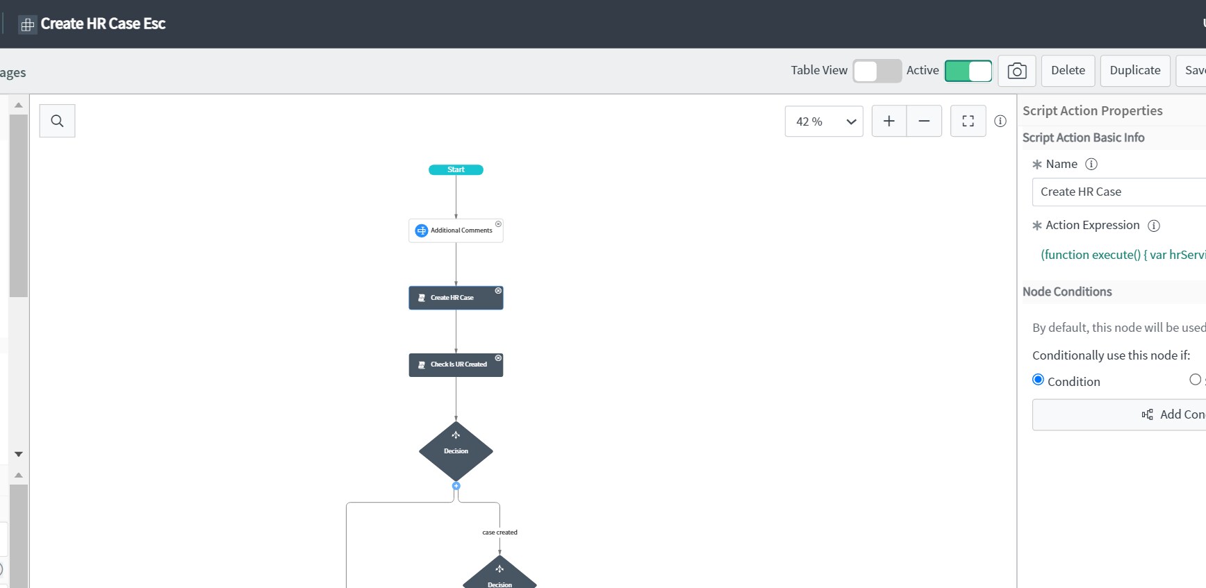

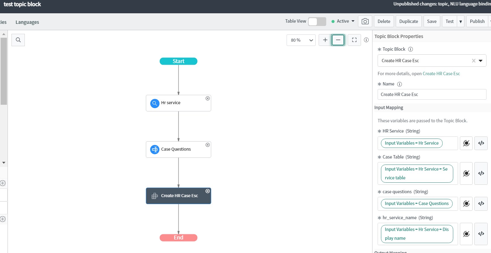

I have created a custom topic - test topic block [screenshot 1] to call a topic block - Create HR Case ESC [screenshot 2] which is a clone OOTB topic block - Create HR Case .
The topic block 'Create HR Case' has case_questions as the input variable that needs to be passed from calling topic 'test topic block'. I'm able to set the other inputs from calling topic but I'm not sure what kind of input I should ask the user to provide for case_questions in test topic so that it can be passed to Create HR Case topic block. If I'm passing any text user input from test topic to case_questions then my OOB script to generate the HR Case is failing [The log in line 16 is not coming] [screenshot 3].

When I'm passing case options to my topic block then the HR Case is not getting created.
However, if I don't pass anything in case questions and make case_question input as non mandatory and modify the script to only pass additional comments as below :
