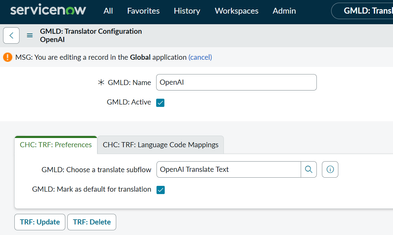

Hi @santoshrega,
I cloned a subflow, changed only the action that calls the API to the service provider to use the service I want, and now my subflow returns the following (as shown in the FlowExecution image).
When I click on the Translate button next to the work note (TranslateAction), my custom subflow is called, but the actual translated content (as shown in image FlowExecution) is not displayed in the UI and remains stuck on Translating.
Do you know what could be causing this? Is there any configuration that I have forgotten or that is missing?

‎03-05-2026 01:22 AM - edited ‎03-05-2026 01:23 AM
Yes, I created a Translator Configuration, otherwise I don't think I could even get my subflow to be called automatically by the Translate button when I click on it.
And my subflow ends in completed and I can't see any log that points me to a possible error.
