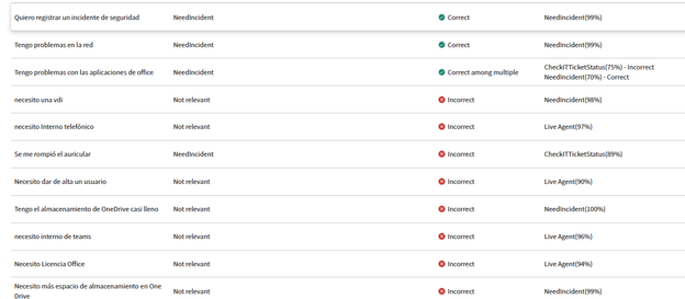

Hello everyone in the community! We need help with our NLU model. It's small, with only three intents initially. We have trained the model to detect these intents and it does this well. We have created a test set with many expressions that are irrelevant to the model so that in tests the bot falls back to Fallback; however, we haven't been able to use the tools to train the bot to dismiss irrelevant expressions because these tools don't allow us to select the model. I'm attaching some screenshots

We have already identified that there are problematic utterances when testing the bot, so we have created a test set with these utterances. When running the tests, we observe that irrelevant utterances are incorrectly directed to wrong intents. The test application reports these errors. We haven't found a way to mark these utterances as irrelevant for the model, and that's why we are seeking help.
Here is a report from the test application
In any case, we greatly appreciate your support and guidance. Thanks @glideFather

The Expert Feedback Loop (EFL) gathers user phrases from the chat logs. The phrases in the tests do not get to the EFL.
The EFL runs once every 30 days. I made it a habit to work the EFL once a month.
When testing, you need to manually make corrections to the intents, publish, test again.
