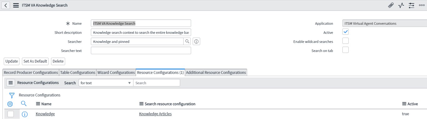

Do you have an active Search Context (i.e. ITSM VA Knowledge Search) that has an applicable Resource Configuration?
Yes, we do have the active search context.
