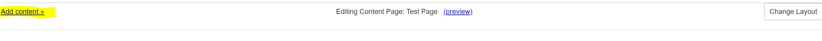

Hi, please follow the steps below to achieve this.
1. Create a page by going to Content Management-> Pages. Fill out form then set URL suffix to your preferred suffix i.e. IARForm. Save the page then click on Edit Page from Related links
2. Click Add Content
3.  Select Content Blocks - > New Dynamic content then click Add here button as displayed below. After that click X on the top right hand to close the window
4. Follow step below
5. On the Dynamic Content page, fill out the form, enter the following jelly code, then click submit
