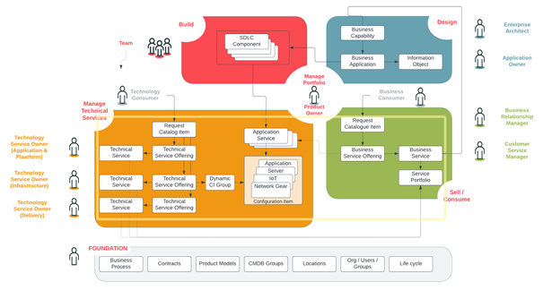

you can also see the need from CSDM (maturity) in context of the needs (stakeholders).
ITSM processes are using a different part of CSDM than eg APM or SecOps:
ITSM
ITSM is in context of Services (Supporting and Consuming Services)

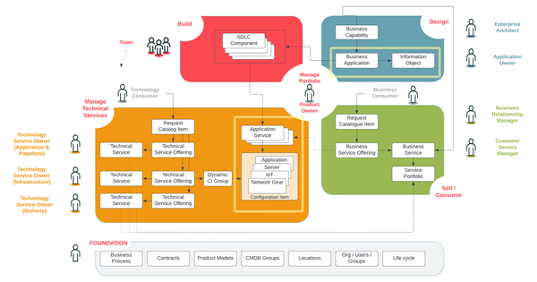

SecOps / APM
SecOps / APM is in context of 'are my Business Application deployments vulnerable / compliant' (also cost).
in this scenario the Infra - / App CIs it 'rolling up' eg Model data to Application Service records to be used in Business Applications.
Without asking if anything is needed it might be the roadmap that drives the needs/maturity level of implementation.
If short term focus is purely ITSM there is less need for asset aspects. In practice there is probably a need anyway, but maybe not in the scope/step of the implementation.
I think you can/need to slice and dice CSDM to implement/mature it step by step.
