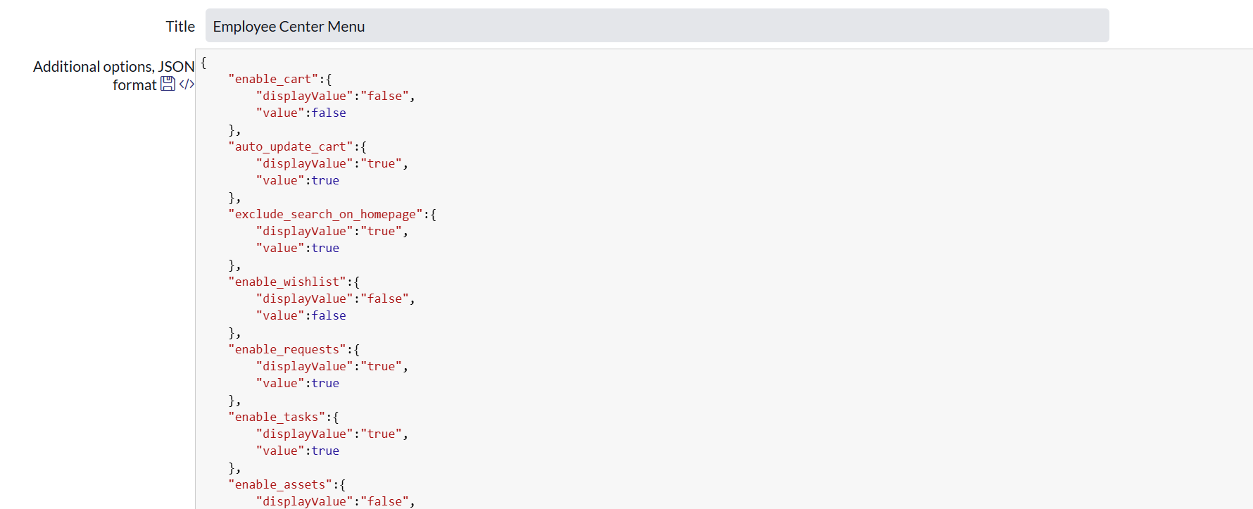

Hi @vidyajadhav ,
You  can  go to the Employee center menu and change the JSON to false for required fields. Please mark this as a solution.

@vidyajadhav
this link has solution
How to remove "my task" and "my request" menus from employee center SP
Steps
1) go to this URL
https://instanceName.service-now.com/nav_to.do?uri=sp_instance_menu.do?sys_id=493d01365368301056c1dd...
2) in the JSON make these 2 as false i.e. value and displayValue

Hi @vidyajadhav ,

@vidyajadhav
Steps
1) go to this URL
