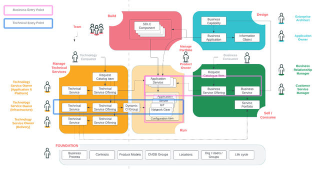

the way I understand it is that you take the Service Offering as 'filter' for the impacted CI(s).
when it is a Business initiated incident the Business Service Offering is the starting point and for applications there is not much more needed to select as in general the End User doesn't know the CI level (unless it is about owned assets).
when it is a Technical initiated incident then the Technical Service Offering is the input:
- event mgmt
- vendor ticktet
- 2nd line incident
event mgmt and vendor tickets are probably automated, but 2nd line ticket might be the use case here.
The Technical Service Offering is the starting point and is supporting xx nr of CIs. In this case 50.000-70.000.
In CSDM the idea is to link those CIs via Dynamic CI Groups, however these are topped to 10.000.
I haven't done it, but I think technically you can add the downstream relation in the svc_ci_assoc table (by your own logic), and then the filter query will be:
All CIs where service_id = Technical service Offering. That is a straight forward query on a flat table. You skipping Dynamic CI Groups that way (used for Data Synchronization and potentially unpacking CIs in Change Mgmt --> but with 50.000-70.000 child CI's I don't think that is a valid scenario.
I think it should be a join table as you need to select the ci_id from the svc_ci_assoc table to select the c mdb_ci record. If that is not done via a join query then the query will be something like:
ci IN (1,2,50.000) which is stretching the limits I guess.
The back end query needs to work where the Service Offering is selected from Business side as well as from Technical side. (I guess) so that might be less straight forward. (check cmdb_rel_ci table as well as svc_ci_assoc table.
Alternatively is to breakdown the Technical Service Offerings in smaller groups that contain less CIs so the Dynamic CI Groups can be used. (still the filtering itself will be somewhat similar)
