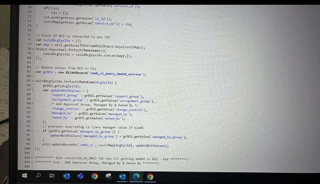

There is one OOTB schedule script name as "CSDM Data Sync". I am trying to make the changes there but not able to achieve. And one more thing for new CIs it working but for the old CIs its not.
Should I change the hours of from javascript&colon;gs.hoursAgo(25) to javascript&colon;gs.daysAgo(400)
Attaching the screenshot and script as well here
Thanks!

But I am having another additional requirement, just like after this configuration, these support group are populating now,
  • Support group
  • Change group
  • Managed by group
I also want to populate the approval group, and assignment group, Managed by and owned by attribute values as well. Kindly help to achieve this.
I have tried to make some changes in "CSDM Data Sync" but it's not working, attaching SS here.
And according to the CMDB manager, another problem is - whatever the value we are changing here for (SG, CG and MBG) via TSO, after 24 hours the value is changed to the old values, its looks like strange, but yes this also happening.
