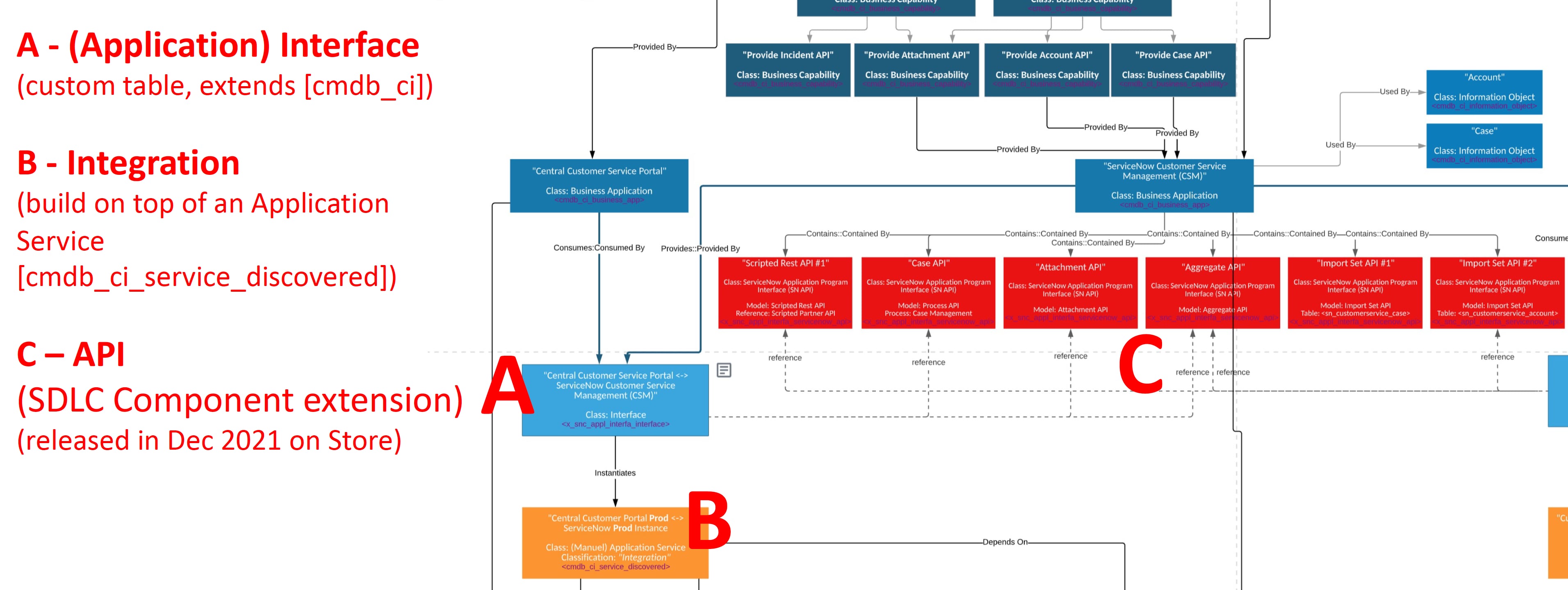

FYI: I also extended the SDLC Component class to be able to define specific API attributes. In my example, you'l notice the red boxes, which are extended SDLC Components, representing ServiceNow APIs 9C). The dark blue boxes, represent the Business Applications. The light blue box, the Interface (A) that collects all information why the 2 Applications are integrated with each other, as well link some of the ServiceNow APIs to it. In the ServiceNow world, we usually use more than one API when we integrate (f.i. the Table API, to read the data, the Import Set API or Process API to insert data, the Attachment API to relate attachments and the Aggregate API, to get some counts.)
