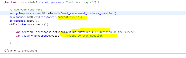

You can write a after insert BR on survey instance table (asmt_assessment_instance) with a condition that state is completed i.e. response has been recieved.
Then you can use Gliderecord query on asmt_assessment_instance_question tbale to fetch all varibales and their values based on the reponse. You can apply own logic for threshold in it and finally is its acheived, you can create a task through the same BR itself.
Script will look like this
