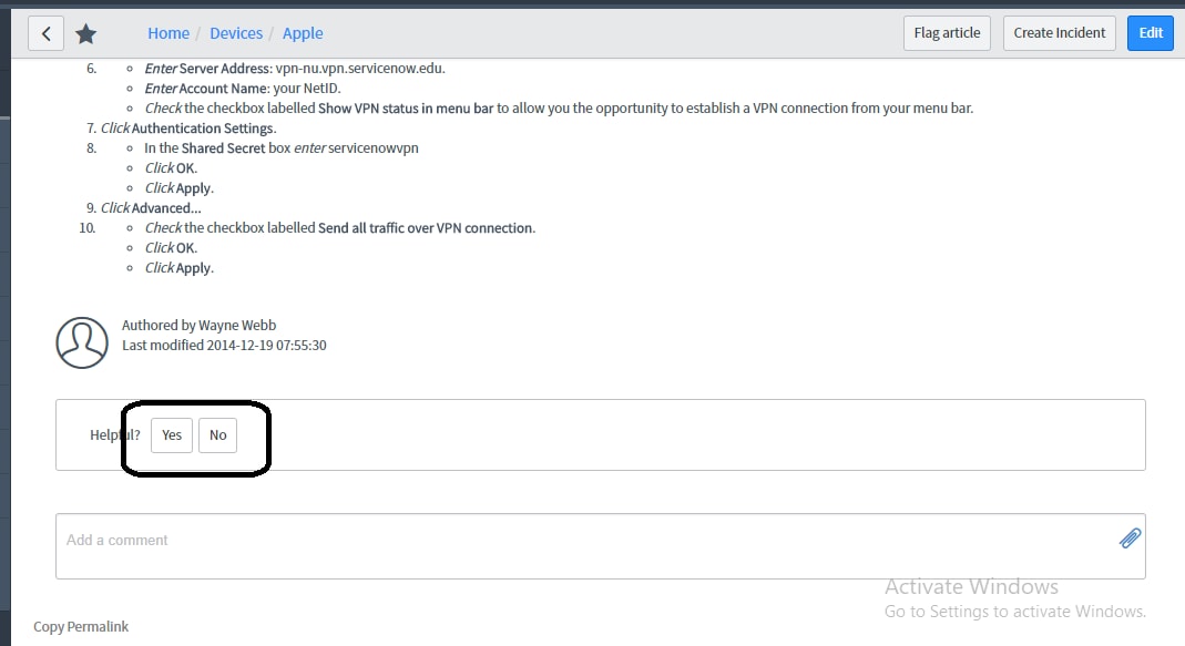

if i clicked YES or NO button in KB ARTICLE then immediately display POP-UP box(message box) with message- Thanks for Visiting
OR
Make Comments box mandatory .
for this i tried to check UI Macro's(it is in readonly) , UI pages but i am unable to understand where need to do changes

Hi Kishore,
Did you add the button Helpful? Yes No from your side or it is out of box.

Hi Kishore,
I did find the Helpful message is out of box and here is the way you can add an alert on click of Yes.
Go to UI Macro -> search for XML contains Helpful? you should find this ui macro 'kb_view_ratings'.
within this UI macro you will see that a function feedback is being called on click of Yes search that and update as per below screenshot:
