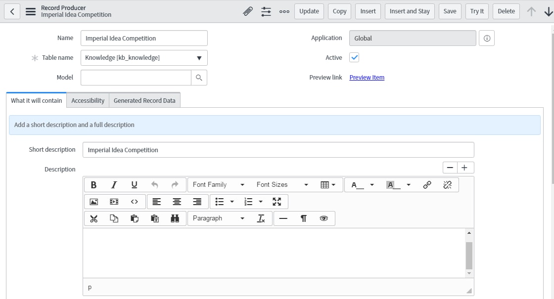

I hope to find help with my issue. I created a record producer to generate a knowledge article. I want these articles to be instantly published, but they are always generated in workflow state "Draft".
I have already tried the following, but nothing helped:
  1. I have set the publish workflow for the Database to "Knowledge - Instant Publish" (OOTB workflow).
  2. I have a Knowledge Template in the record producers Tab "Generated Record Data", where I have set the field kb_knowledge.workflow_state to "Published"
  3. I have tried scripting the field like this: kb_knowledge.workflow_state = 'published';
Now I'm really out of ideas and hope, someone can tell me how to configure the record producer.

Hi Brad,
thanks for your quick answer, unfortunately it didn't work.
I don't have much of a script actually, only the one line for the workflow_state that you posted.
As you can see, I did not change anything in the approval. I have already tried setting the workflows_stage to "draft", but that did not change anything.
Thank you,
Lisa
