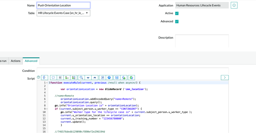

Hi there,
Can anyone help with the code?
I am trying to Orientation Location which is reference field to cmn
_location table.

@Simran321 are you trying to set "remote" as location ? what is the issue ?
Yes, I am trying to add Remote as Location if worker is contingent. Remote is a location on Location table @Gangadhar Ravi
Bert_c1
Try 'if (orientationLocation.next()) {' before line 8 and add '}' after line 14. seems line 11 above should be:
current.u_orientation_location = orientationLocation,sys_id.toString();
for a reference field named 'u_current_location'.
good luck debugging your business rule script.
Kenny Caldwell
Add orientationLocation.next() after orientationLocation.query().
