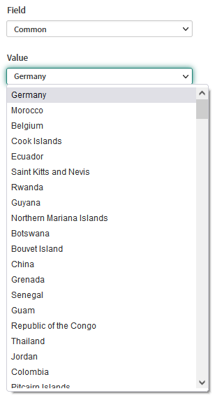

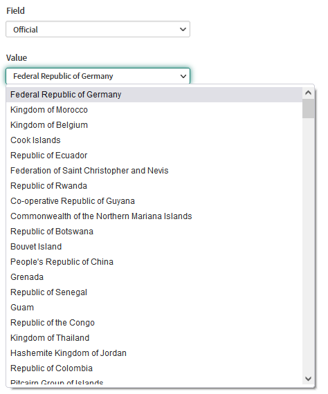

Here's a sample script.
Create a Service Catalog with 2 fields of Select box. The first field named "field" contains values "common" and "official". The second field will contain values obtained from REST API call.
onChange Client Script on field "field".

Execution results. It takes about 2 seconds to fill the second field with values.
