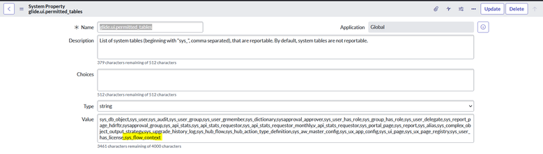

Table sys_flow_context can be added in this list by making following changes.
The name of this system property is glide.ui.permitted_tables you can locate it in System Properties module on your instance.
Add sys_context_flow table in the value field and saved it.
Went back to my API explorer and tried searching for the table again and there I found it this time.
