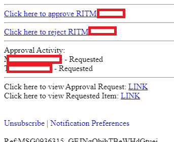

First, Can you verify if your approvals have approve/reject via email( OOTB Servicenow Provides this but its upto our requirement)

So along with the Approve and Reject Button, there would be a "Approve XX" button, which, if pressed , would approve AND set the variable to TRUE
Then i could handle the workflow from there by using IF variable = true etc etc
‎03-09-2022 04:41 AM
Yes.
You need to use these buttons for this specific item only.
