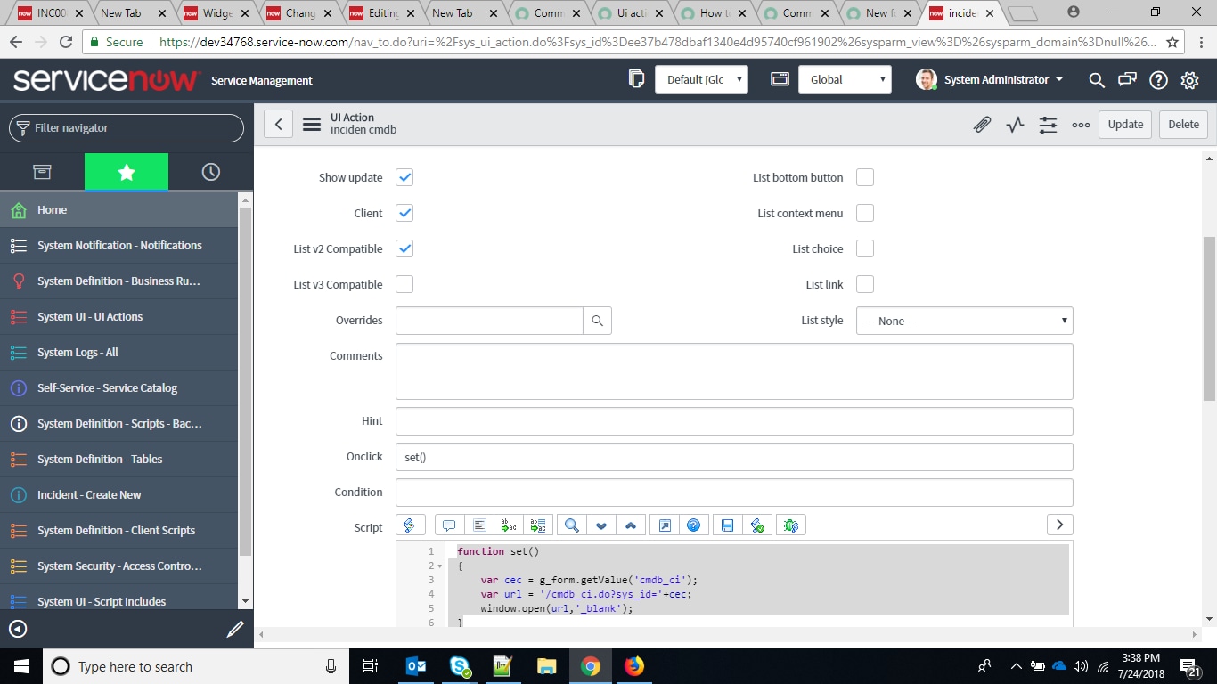

07-24-2018 03:10 AM
try now
function set()
var cec = g_form.getValue('cmdb_ci');
var url = '/cmdb_ci.do?sys_id='+cec;
window.open(url,'_blank');

07-24-2018 02:39 AM
recordsys_id = current.cmdb_ci;
action.setRedirectURL('cmdb_ci?sys_id=' + recordsys_id);
I used the above code in ui action ,but no luck 😞
