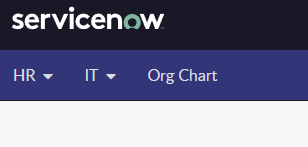

Here is my OOTB Employee Portal from my personal dev. You will see that it shows HR, IT, then Org.
I cloned the original taxonomy and reordered HR and IT... But, it still shows HR as first as seen above. Now I will change my portal taxonomy to the new clone one and:
Here is me switching them out:
One active (the new) and the original false:
Refresh the portal page and now IT is first:
I would check on this portion of the steps to make sure you are using the correct taxonomy with the new portal.
