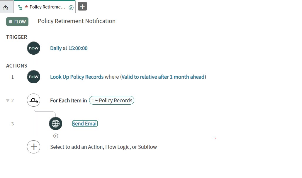

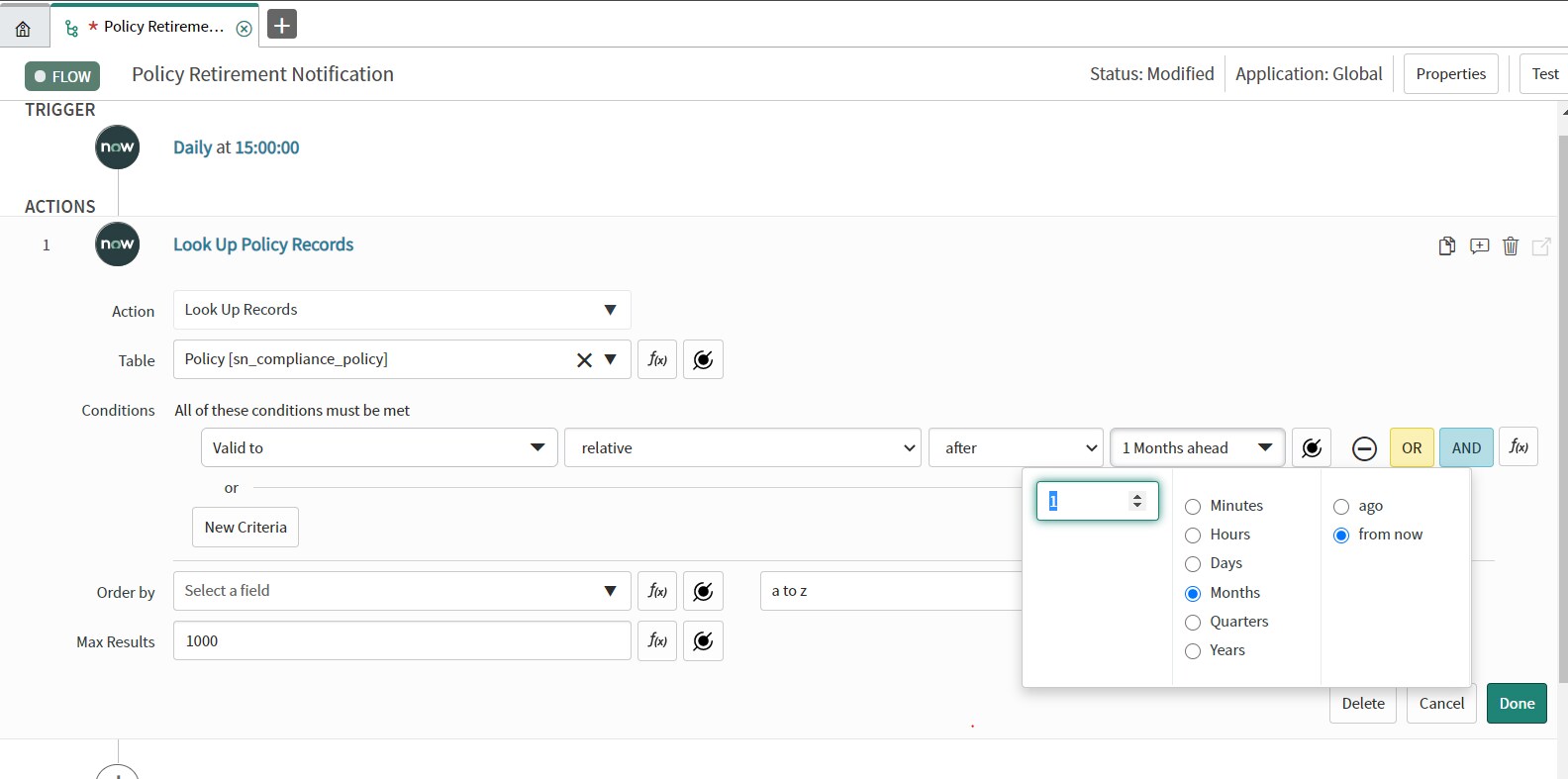

Create a simple flow for this using flow designer.
See this:
Full flow:
Ashutosh
This is a better approach. Thanks Ashutosh!!
I was thinking about these two alternatives - the event approach requires coding experience.  On the Flow approach - I probably wouldn't run it daily - maybe weekly.  Expiring policies should be able to handle that type of frequency.
