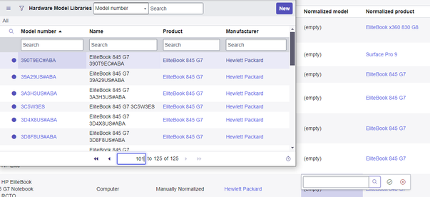

Hi Ashok, thanks for the reply! We are using HAM Pro and it is true the content service does a lot of work for us. Our main problem though is missing data from discovery to isolate down to a particular model of an HP, so this is the roadblock we are hitting:
We can narrow down the product to an EliteBook 845 G7, but are not able to pick out a particular model of that product from this list of 125 options.

If your organization has purchased the HP Model with a specific configuration need for your organization, there might be chances that it will not be available in the Hardware Library. If discovery has identified a model number, try creating a custom hardware product model and let it pass through content service for ServiceNow content curation team to validate and update content library. It will work if the PID/Model number information on the device and discovery identified model are the same. If it is different, then you may have to dig this further.
We are having the same issue - however we used the HP warranty site (https://support.hp.com/nz-en/check-warranty) to enter the serial number and this provides us the model number in most cases, which matches with one in the list.
