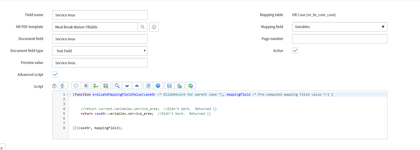

When setting up PDF Template Mappings, is there a way to map variables from a Record Producer to the field name on an HR PDF Template?
We have a Record Producer tied to an HR Service that calls a PDF Template.  A variable on this Record Producer has a value we would like on the PDF Template.  I have tried the Advanced script to return current.variables.variable_name and caseGR.variables.variables_name.  Neither one worked.

Thanks, Mike.  I was able to resolve this with a more simpler method.  My first tests were close, but resulting in '{}' populating in the PDF Template Field.
After some debugging, I found the following script to be working as intended.  Setting toString() gave me the results I wanted.  I hope there are no unintended consequences of this.
