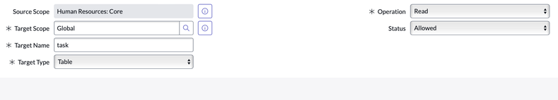

Hi @Lukasz Bojara ,
Re-check if you are creating correct Restricted Caller Access Privilege record as from the mentioned post:
