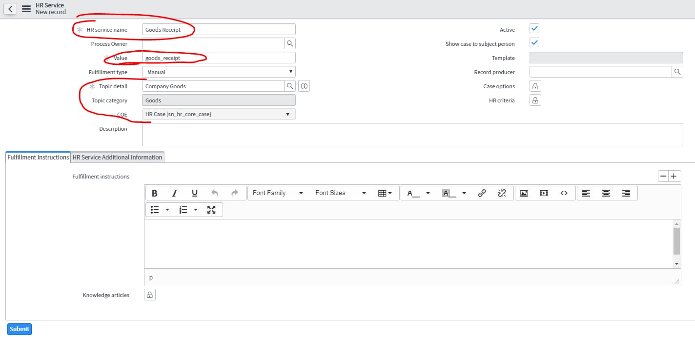

To your exact last question, with using the HR Core Case table, adding Goods receipt and Purchase Order for new HR Services, yes you can certainly do that. But, you either have to tie them to an existing Topic Category/Detail, or create new ones from scratch. My guess is, you would want to create new Topic Category/Detail to tie them into.
Therefore, you would go to Topic Category module and create New:
Be sure to select the COE you want them to fall under, in your case, adding them to the HR Core table - and then enter in a name for the Topic Category (Maybe Goods)
Once you save that, then we can do the Topic Detail
Give the Topic Detail a name (and this is just me spit-balling)
Now we can do your HR Service(s)
And just take off from there 🙂
Now we can use those HR Services, under HR Case core table:
